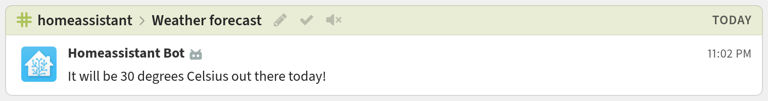

  6. Finally, you need to configure a trigger for the service by adding an automation entry in the HomeAssistant configuration.yaml file.
    automation:
      trigger:
        platform: sun
        event: sunrise
      action:
        - service: notify.notify
          data:
            message: "It will be 30 degrees Celsius out there today!"
            title: "Weather forecast"
    The data object takes at least a message property and an optional title parameter which will be the conversation topic and which defaults to homeassistant if not given.
You're done! Your Home Assistant notifications may look like this:
